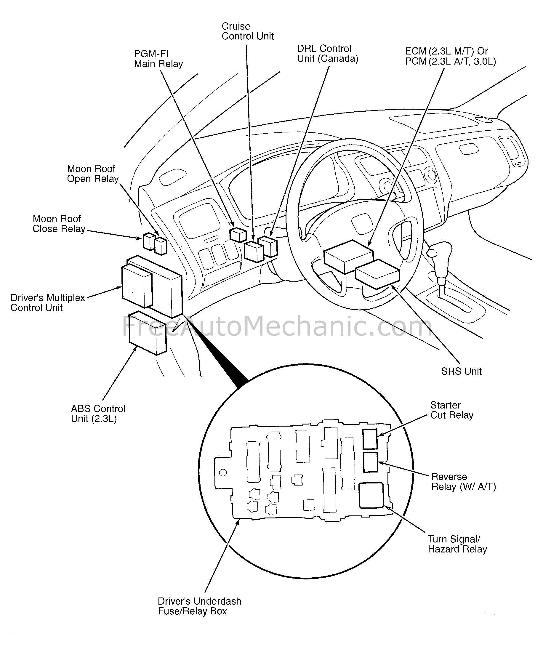

Where is the fuel relay switch
This vehicle utilizes the PGM-FI Main Relay for the fuel relay. It is located under the dash to the left of the steering column.
PGM-FI Main Relay – Fuel Relay Location Diagram
