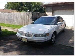

My car completely died last night. i had to use the release key switch to remove my keys after trying to start it and not even getting a single light on the dash. The only lights that were on an orange bulb in the headlights. I’ve now gotten the inside power working by resetting and using a trickle charger. Those lights are still on now while charging, what are they? and how do i get them off?
With your charger connected, unlock and lock the car with the door closed. This should allow the headlights to time out and charge the battery. Another option would be to disconnect one of the battery terminal ends and charge the battery that way. Remember to put the ignition key in and turn it to the “ON” position before connecting the battery back up. This is to keep the alarm system form activating if it is equipped.
