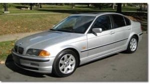

The door lock broke and i changed it . I don’t have the button for the alarm… After I changed the lock my car is in double lock down mode.. How do I get it to disengage

Disconnect battery.
Wait 2 minutes.
Put key in ignition and turn it to “ON” position.
Connect battery.
Turn key from “ON” to “START”.
Done.
