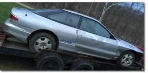

after replacing clutch master cylinder need to know how to bleed the lines and bring the pedal back up off the floor
