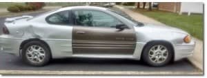

2004 pontiac grand am 3.4l
2004-pontiac-grand-am
Replaced the ignition switch and pass-lock tried to do the relearn procedure and the security light stays on and car wont start still.
