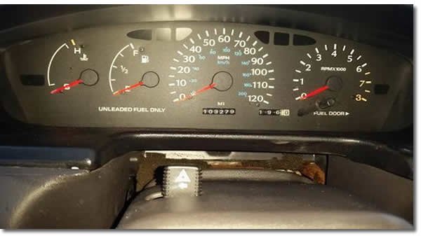

dodge neonDriving my Dodge Neon and all of a sudden it dies… not getting any fire to the coil pack so I put a new one in that’s wasn’t the problem.. the gauges work but the speedometer does sometimes the rest works fine cause I was thinking it might be the icm… or the cps but idk how those go out need help asp got me stuck in a bad situation
Many times spark and fuel are missing at the same time. This can be caused from a faulty crank position sensor and failed PCM fuse. Make sure you are getting injector pulse before making that ruling. If all you suffer from is lack of spark, then stay the course.
