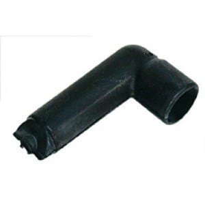

Example location:
Ford Evaporator core drain plug location diagram
