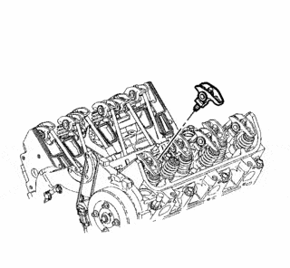

This is a common occurrence when the pushrods are not marked when removed. The intake and exhaust push rods are not the same length in this engine. To avoid this in the future, poke holes in a piece of cardboard and mark the front so they are kept in the same order they are removed. For now you can just measure them.
Push Rod Repalcement diagramImportant
 Place the valve train parts in a rack in order to ensure that they are installed in the same location from which they were removed. Intake pushrods measure 144.18 mm (5.68 in) long. Exhaust pushrods measure 152.51 mm (6.0 in) long.
