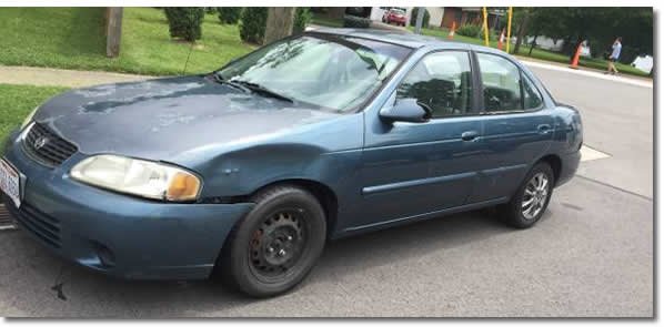

2002 Nissan SentraWill 2001 Nissan Altima parts fit on my Nissan Sentra like the catalytic converter, motor mount and struts and brakes?
RESPONSE
For the majority the answer is NO. Some small insignificant parts like lug nuts and light bulbs, etc. will transfer but not the majority.
