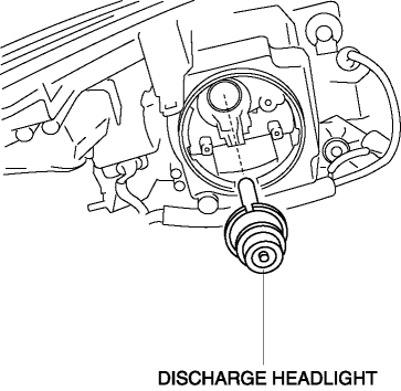

  1. Remove the discharge headlight.
HID Headlight Removal 2011 Mazda Speed 3
CAUTION:
  • The bulb generates extremely high heat when it is illuminated. If the surface of the bulb is soiled, excessive heat will build up and the life of the bulb will be shortened. When replacing the bulb, hold the metal flange, not the glass.
