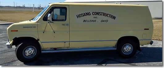

Did my vehicle come with a coolant recovery tank? There is a long tube from the radiator that looks original but no tank. If yes, would a universal overflow tank do the trick? Thank you.
Yes and Yes.
