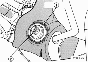

1.Install key in lock cylinder. Turn key to run position (retaining tab on lock cylinder can be depressed).
2.The shaft at the end of the lock cylinder aligns with the socket in the end of the housing. To align the socket with the lock cylinder, ensure the socket is in the Run position (Socket in Lock Cylinder Housing) .
key wont turn lock cylinder replacement1 – LOCK CYLINDER HOUSING
2 – SOCKET
3.Align the lock cylinder with the grooves in the housing. Slide the lock cylinder into the housing until the tab sticks through the opening in the housing.
