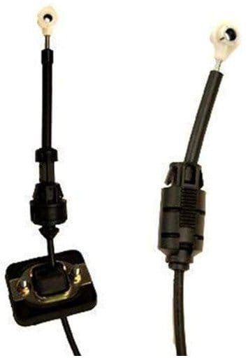

It is common for the shift control cable to fail and need to be replaced. The labor time involved for replacing the shift cable is 3.0 hours according to Chilton Manual. So if the mechanic is charging $100 per hour, you are looking at $300 labor plus parts cost. Here is the cable you need. I double checked to make sure it is the proper cable for your specific car. It carries a cost of $44.
