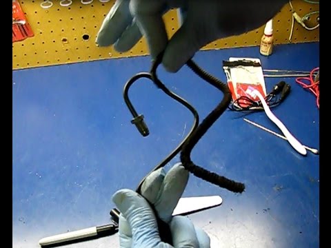

Simple version, unscrew the brake line from the the caliper and master cylinder. Remove any mounting along the brake line. Pull it out being careful not to bend it as you will want to use it as a guide to bend the replacement brake line.
