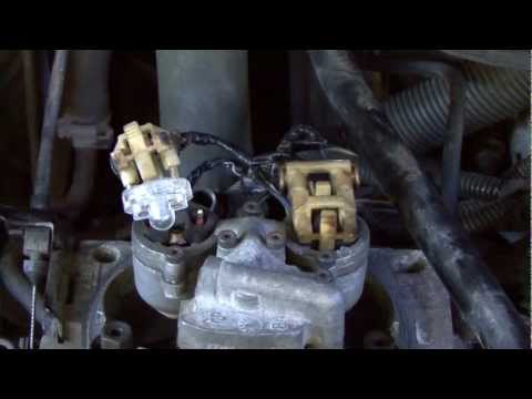

How to check injector pulse on your TBI
How to check the pulse on your Chevy TBI
