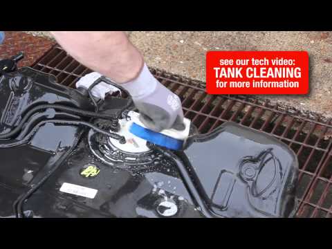

Fuel Pressure Regulator Location
The fuel pressure regulator is mounted on the fuel sender assembly.
