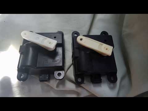

This is common to a failing mode/blend door actuator. The actuator is a tiny electronic device that opens and closes the doors inside the ventilation system. This allows it to switch from hot to cold.
When the vehicle sets, heat and moisture tend to affect these components. And when first put in use after setting they have a harder time functioning properly.
How to replace Mode Actuator 2001 Nissan Pathfinder
Mode Actuator Installation in 2001 Nissan Pathfinder

  2. There is more than one actuator in the system. The temperature hot/cold blend door actuator would be the one having the issue. And more than likely you will notice the issue more on HOT and HUMID days. As the days get cooler, the issue may appear less often. The video is for illustration purposes to give you an idea of what an actuator looks like and how it functions.
