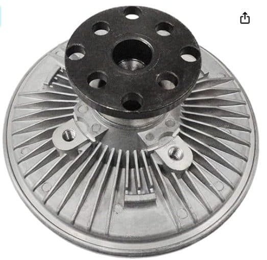

Clutch Fan
Clutch fan can also be picked up pretty reasonable for under $40 and like i mentioned earlier, it takes about an hour to swap it out.
