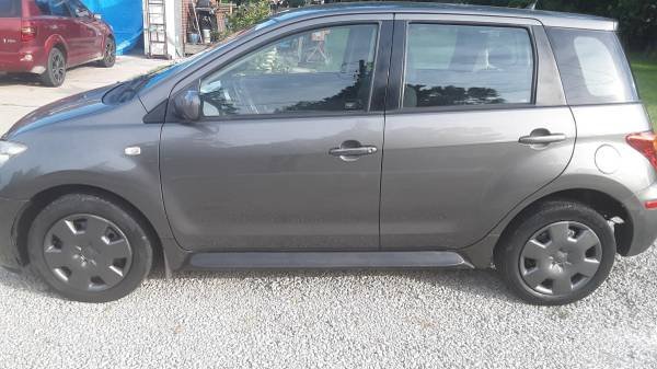

2006 Scion XA
I’m trying to figure out if I just have a radiator leak, or is it also the head gasket. Engine keeps losing water, visible but sporadic leak in bottom of radiator(I’ve replaced thermostat and water pump), also, there’s oil splashed on engine. Would a blown head gasket cause the radiator to leak as well? No white smoke or white on oil cap, car runs fine otherwise.
