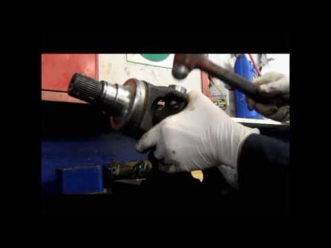

Check your Joints
As for disengaging the 4×4 sometimes the vehicle needs to be driven in reverse about 10 feet for it to release properly. This is normal.The light changes to allow you to know it received the request to do so.
As for the odd noises and popping, this too is normal when trying to operate the vehicle in 4×4 on DRY paved roads. The tires will grabIf these noises seem to be excessive you will want to also check you front drive shaft u-joints. Then check your front axle shaft joints.
