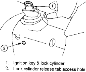

How to replace the multi-function switch
Multi-Function Switch, Replace
- Insert ignition key into ignition switch lock cylinder and turn to RUN position.
- Push ignition switch lock cylinder release tab, Fig. 1, using suitable punch while pulling outward on ignition switch lock cylinder.
- Twist tilt wheel handle and shank counterclockwise, then remove shank.
- Remove upper and lower steering column shrouds.
- Disconnect multi-function switch electrical connectors.
- Remove multi-function switch retaining screws, then the switch.
- Reverse procedure to install.
