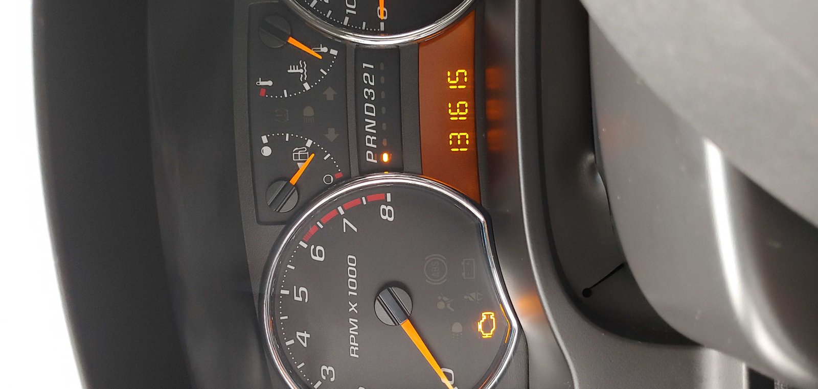

I’m curious where my odometer normally reads it has a strange set of numbers. 13 16 10. I was only a mile and a half or so from home and the last number changed 10 11 12 ending on 13 16 15. Can’t seem to find anything anywhere to tell me what this means. My apologies if this is a stupid question… But hopefully you can tell me what this is and why it’s there.

Was unable to locate any information on this as well. I will post it in case someone else has seen it they can respond.
You could try this reset method to see if it clears. Then test to see if it comes back.
Reset Stem Method
1. Turn ignition switch to RUN position, but do not start engine.
2. Press and hold reset stem in lower center of instrument cluster until Oil Life message is displayed.
3. Once alternating OIL LIFE and RESET messages appear in display, press and hold reset stem until several beeps sounds This confirms oil life system has been reset.
4. Turn ignition key to Lock position. If CHANGE/OIL message comes back on when engine is started, engine oil life system has not reset. Repeat procedure.
Alternate Method
1. Turn ignition On, but do not start engine.
2. Fully depress and release accelerator pedal three times within 5 seconds. Several beeps will sound. This will confirm system has been reset.
3. If CHANGE ENGINE OIL lamp flashes for 5 seconds, this indicates system has reset.
