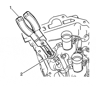

  7. 2010-buick-enclave-valve-spring-compressor
    Install the EN 46110 on-vehicle valve spring compressor above the applicable cylinder as shown.
  8. Tighten the EN 46110 on-vehicle valve spring compressor valve spring compressor nut (2).
  9. 2010-buick-enclave-valve-spring-removal
    Remove valve keepers
    Remove the valve keepers.
  10. Loosen the EN 46110 on-vehicle valve spring compressor valve spring compressor nut.
  11. Remove the valve spring retainer.

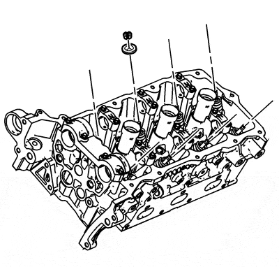

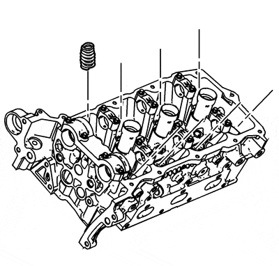

  12. 2010-buick-enclave-valve-spring
    Remove the valve springs.
    Install the valve spring.

  4. 2010-buick-enclave-valve-spring-removal
    Install the EN 46110 on-vehicle valve spring compressor above the applicable valve spring as shown.
  5. 2010-buick-enclave-valve-spring-compressor
    Install the valve spring keepers.
  6. Remove the EN 46110 on-vehicle valve spring compressor .
