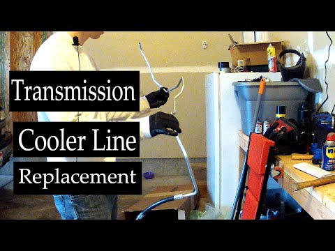

The transmission cooling lines/hoses are on the passenger side. They may have been bent or kinked and no longer allowing the fluid to flow. This would cause an issue. That would be the first thing to look at and consider as you have already ruled out the possibility of transmission fluid level low.
How to Replace Lower Transmission Cooling Hose
