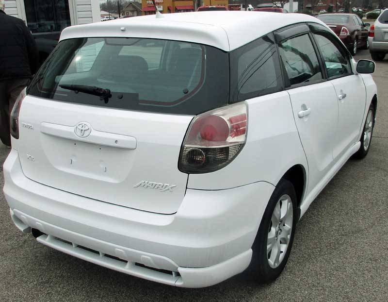

I was traveling on the highway going 80km/ hr slammed on my brakes to avoid deer. Since than there is a vibration in the front end when I’m driving. May someone pls. It is a 2005 Toyota Matrix base model.
Help me to narrow down what is wrong
