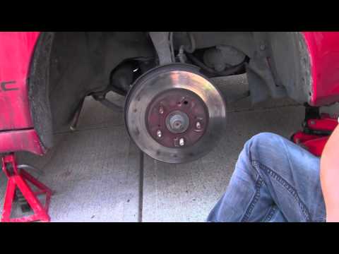

We are trying to figure out how to replace the front wheel studs on a 1998 Honda Accord EX, but all methods we’ve seen described so far involve a grinding, but we do not have one, nor wish to purchase one. Since it is continuously referred to as “the grinding method”, that would seem to imply there are OTHER methods as well, correct? I mean, Honda couldn’t possibly have designed these Accords to only be able to replace the wheel lug nut studs on them by taking a grinder to them, right? lol
You are correct, there is another method for replacing the wheel stud. It is the method of doing it “the right way”. If the manufacturer didn’t want all the material on the wheel stud they would have made the studs already cut. All the grinding will weaken the stud and I do not recommend it.
