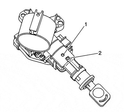

5.
Note
There are two retainers on the ignition lock cylinder. Depress both retainers to remove the lock cylinder from the ignition and start switch housing.
Depress the first retainer through the ignition and start switch housing access hole (2) with a small allen wrench or similar pick-type tool. The lock cylinder will back out slightly.
6.Depress the second retainer through the ignition and start switch housing access hole (1). The lock cylinder will back out slightly again.
7.Pull the ignition lock cylinder out enough to locate the second retainer in the ignition and start switch housing (2).
8.Depress the second retainer though the ignition and start switch housing access hole (2) a second time. The lock cylinder should release from the housing. If not, the lock cylinder may need to be moved in and out several times to align the retainer correctly in the hole.
9.Remove the ignition lock cylinder from the ignition and start switch housing.
