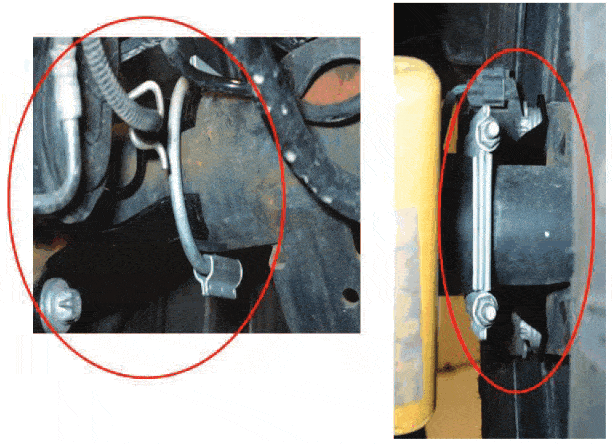

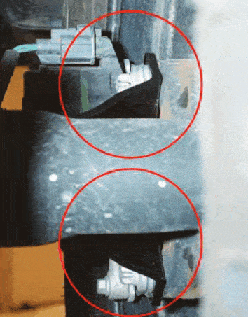

2. Loosely install one of the brackets with the caliper mounting hole on the brake flange on the inboard side using one of the new bolts provided in the kit (Fig. 2).
Fig. 2
One Bracket Installed into Position
3. Repeat Step 1 for the second bracket on the same caliper (Fig. 3).
Fig. 3
Both Brackets Installed
4. Loosely fasten the brackets around the axle tube using the U-clamp and nuts provided in the kit to keep the brackets from twisting when tightening to specifications (Fig. 4).
5. Tighten the caliper bracket bolts to 100 N·m (74 ft.lbs)
(Fig. 3).
6. Tighten the U-clamp nuts to 45 N·m (33 ft.lbs)
(Fig. 4).
Fig. 4
Brake Brackets and U-Clamp Installed
7. Repeat Step 1 thru Step 6 for the caliper on the other side of the rear axle.
