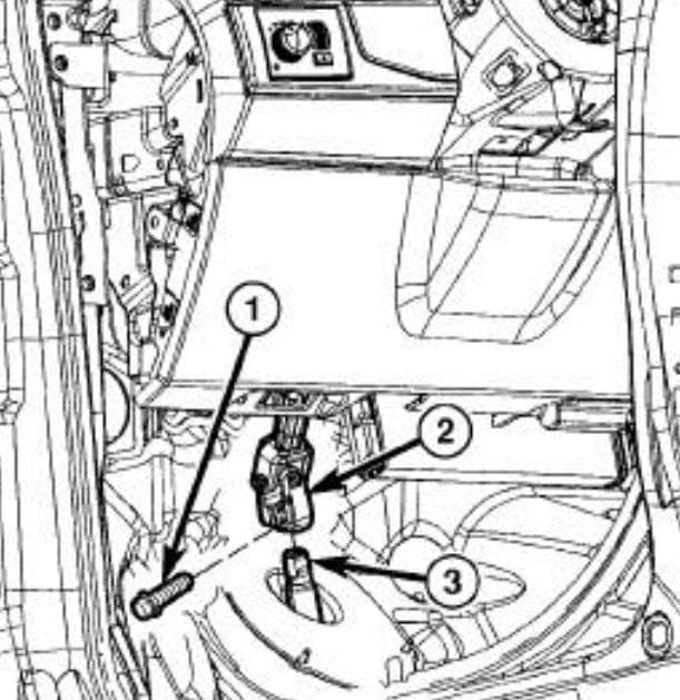

When driving my 2015 Chrysler Town and Country, as I turn the wheel about every 1/4 turn, there is a “clunk” sound somewhere in the dash. Is there a u joint that may be damage or something else that needs repair?
Yes. The Intermediate Shaft (2) has a u-joint. It is located under the steering wheel at the end of the steering column.
2015-chrysler-town-and-country-intermediate-shaft-diagram
  1. Intermediate shaft bolt
  2. Intermediate shaft
  3. Intermediate shaft extension
