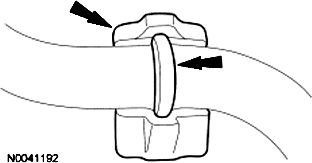

sway bar
Tighten left hand side first. Inspect stabilizer bar bushings for wear or damage. Install new bushings as required. When installing left hand side sway bar bushings onto sway bar, match groove in bushing to upset on sway bar.
