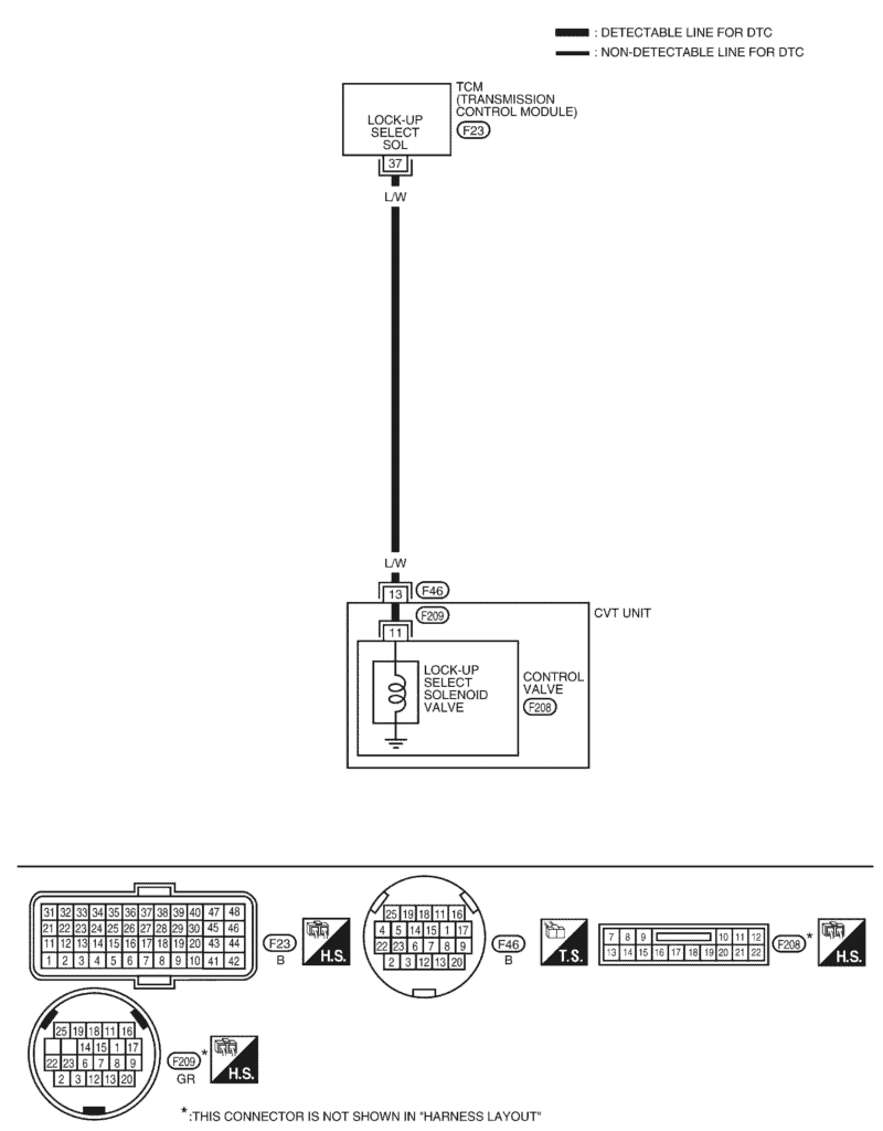

Nissan Code P1740 – Lockup Solenoid Valve Circuit
Code P1740 Possible Causes
- Low on transmission fluid
- Dirty or contaminated transmission fluid
- Faulty lockup solenoid select valve
- Lockup select valve wiring harness is open or shorted
Lock-up Select Solenoid Valve Wiring Diagram
