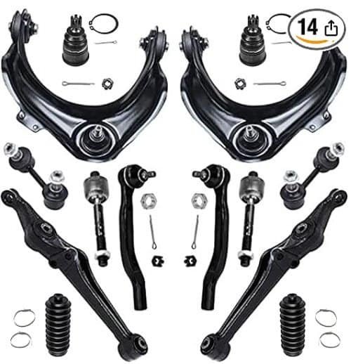

The first thing that came to mind was that I thought you had a 2002 Honda Accord EX. But either way the parts should work. After looking up the parts and crossing the numbers I had a different thought. Maybe at some point there where some aftermarket parts used. This may cause the issue you are having.
Maybe the best thing would be to replace all the components at the same time so the all match up. They do offer a kit online. I looked it up and is less than $300 for the whole kit. 18 pc Front and Rear suspension kit.

Package Includes:
2 Rack and Pinion Bellow Boots
1 Front Outer Tie Rod End – Driver Side
1 Front Outer Tie Rod End – Passenger Side
2 Front Inner Tie Rod Ends
2 Front Upper Shock Mount Bushing
2 Front Lower Ball Joint
1 Front Sway Bar End Link – Passanger Side
1 Front Sway Bar End Link – Driver Side
1 Rear Sway Bar End Link – Passenger Side
1 Rear Sway Bar End Link – Driver Side
1 Front Lower Control Arm – Passenger Side
1 Front Lower Control Arm – Driver Side
1 Front Upper Control Arm & Ball Joint Assembly – Driver Side
1 Front Upper Control Arm & Ball Joint Assembly – Passenger Side
This Kit Fits:
Honda Accord 1998-2000 2.3L L4 Sedan 4-Door
Honda Accord 2001-2002 2.3L L4 Sedan 4-Door; Coupe 2-Door
