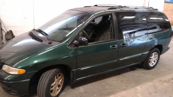

I changed my brakes all the way around. It has front disc and rear drum brakes on my 1998 Dodge Grand Caravan.
I Bled them starting from the furthest away from the master cylinder and worked my way to the front. They worked Good. After a week it seem like they needed bled again. I checked the fluid and added some.
My brakes don’t work until I press halfway down on the brake petal, if I go a little further and to the floor it seems like they stop working until I lift up and press again but still only works when petal is pressed halfway down and barely slows you down when to the floor. I noticed my ABS light was on so I looked around some. I found that my rear passenger side abs wheel speed sensor was missing it’s bolt and was just hanging there out of it’s correct place. Could this be causing air to get into my braking system?
