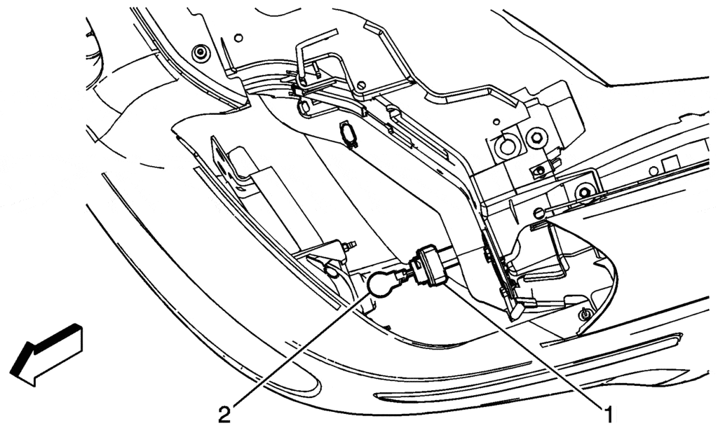

How to Replace Turn Signal Bulb
- Remove headlamp assembly to access bulb socket if required.
- Turn socket (1) a quarter turn counterclockwise and remove, Fig. 1.
- Pull bulb (2) straight from socket, Fig. 1.
- Reverse procedure for installation.
