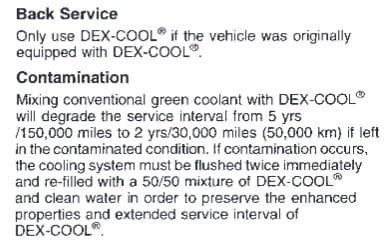

As it turns out your vehicle requires DEX-COOL anti-freeze/coolant. DEX-COOL is typically orange in color and should not be mixed with Green anti-freeze. Using the wrong anti-freeze will result in internal cooling system gasket failure. Back in December of 2007 GM lost a DEX-COOL class action lawsuit.
From the Manual:

I guess I will get anti-freeze flushed & replaced with Dex-Cool Mixture.
Do u suggest getting it flushed professionally?
If you do not know how or do not have the tools to do it yourself, a professional would be a good choice.
