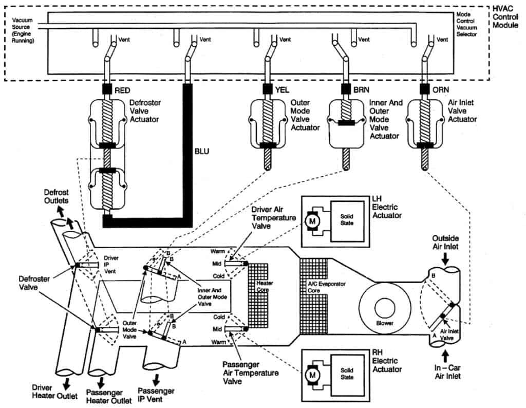

First off, this system uses both vacuum actuators and electronic actuators. The actuators for the selector switch may have lost there vacuum. This may be from not being hooked back up properly if disconnected. The vacuum hoses connect at the back of the control head in the dash. The hoses may also have gotten brittle and cracked. look for these signs when checking them out. Lastly, use the provided vacuum diagram below to gain a better perspective on how the system works.
