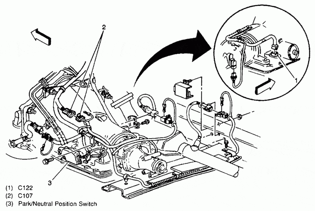

The gear selector switch (park/neutral position switch) on the side of the transmission that was just replaced. Check the connector first to make sure it didn’t just come unplugged. Also you can try moving the shifter into neutral as a test to see if it is just not adjusted right. Also check the CRANK Fuse.

Park/Neutral Position Switch Location
