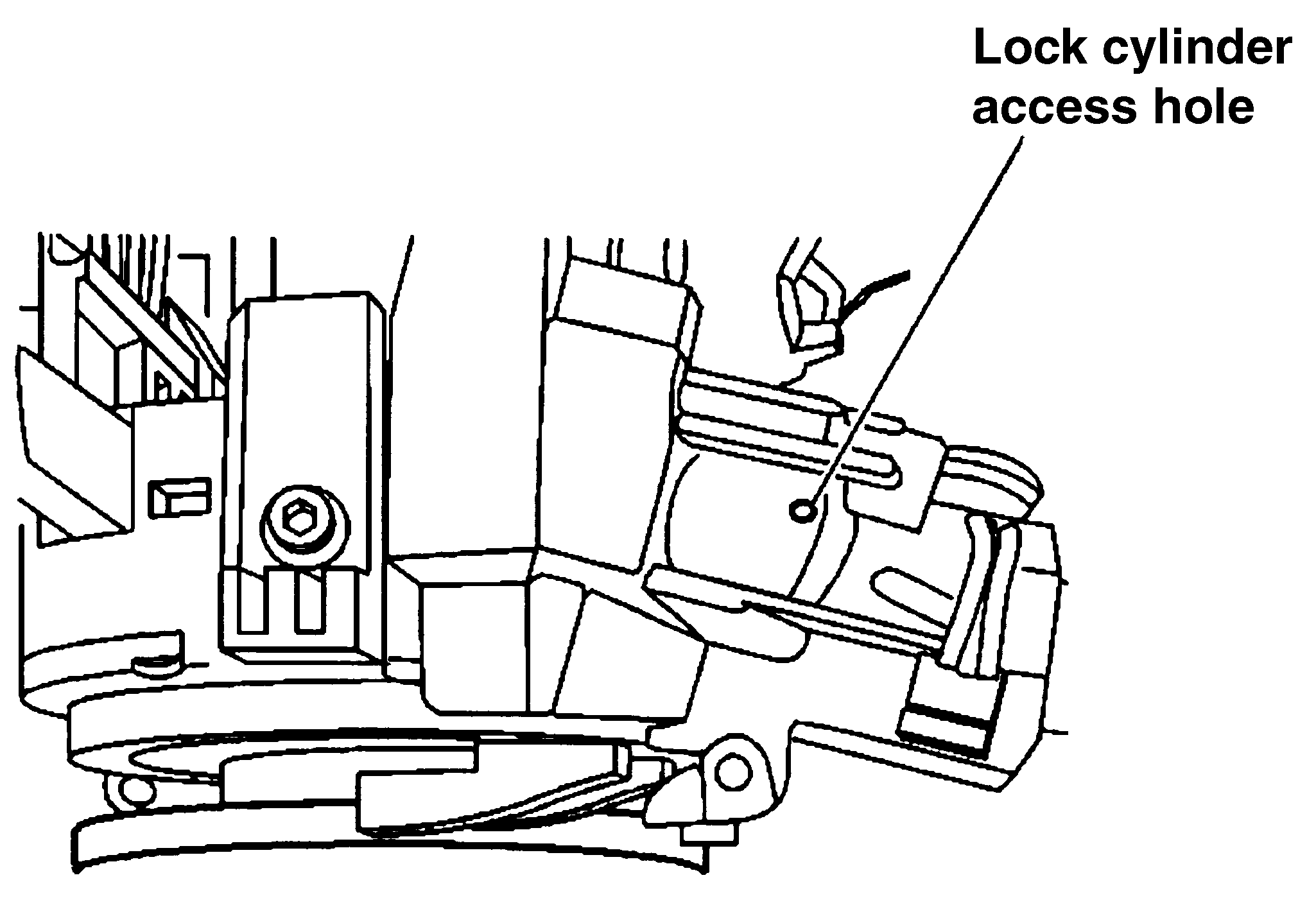

IGNITION LOCK, REPLACE
- Remove upper and lower steering column shrouds.
- Turn ignition lock cylinder to start position.
- With a suitable awl, insert tip into ignition lock cylinder access hole, Fig. 1.
- Push down and hold ignition lock cylinder retaining pin.
- Turn lock cylinder to Run position.
- Pull lock cylinder away from steering column.
- Reverse procedure to install.

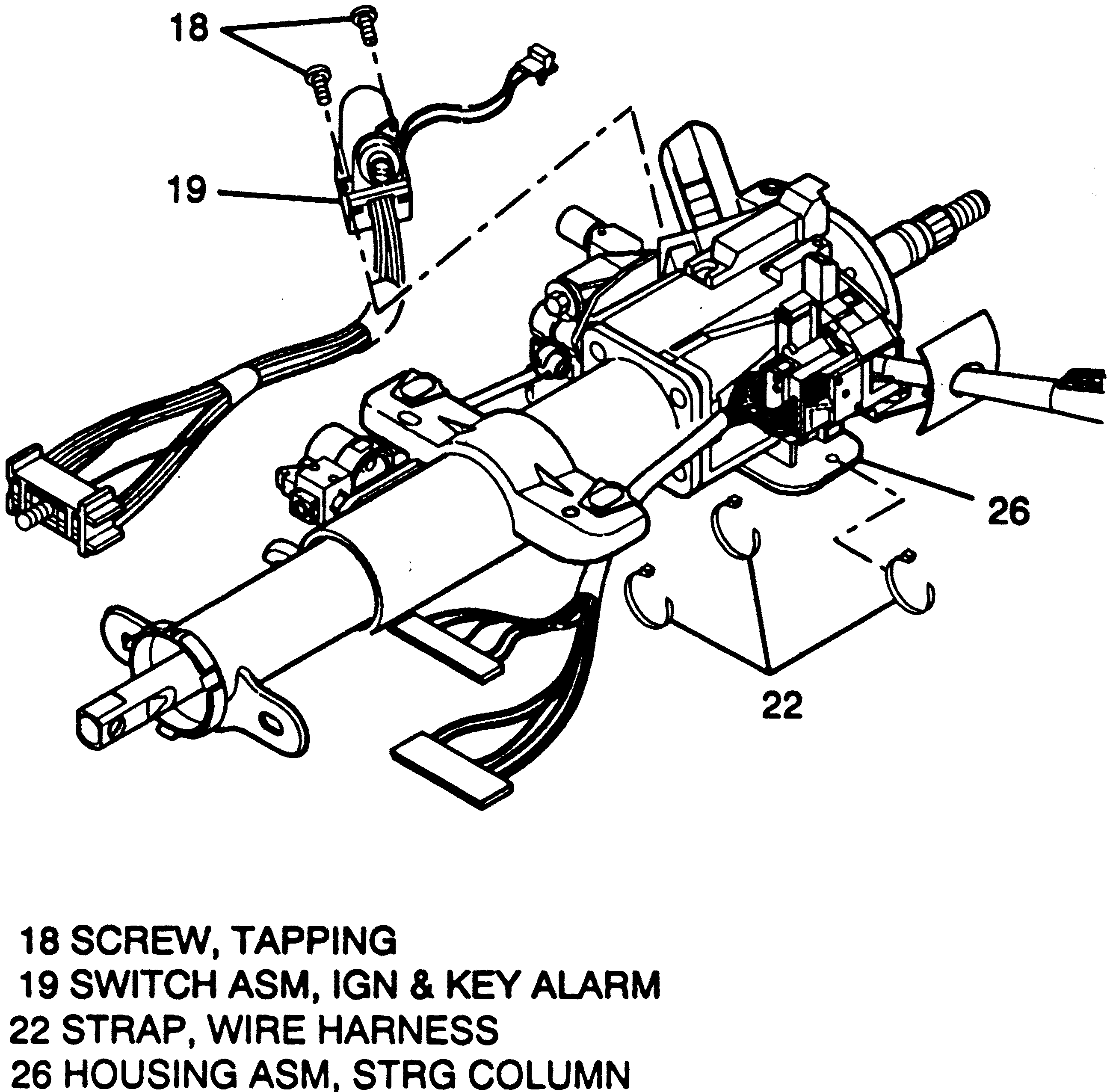

IGNITION SWITCH, REPLACE
- Remove steering wheel as outlined under “Steering Wheel, Replace.”
- On models equipped with tilt column, remove tilt lever.
- On all models, remove two tapping screws from lower column shroud, then the lower shroud.
- Remove two Torx head screws from upper shroud.
- Gently pry retaining clip on key alarm switch with suitable screwdriver, then rotate switch 1/4 turn and remove.
- Remove Pass Key connector from lock module assembly, Fig. 1.
- Remove two tapping screws from ignition switch assembly.
- Remove wiring harness from slot in steering column head assembly.
