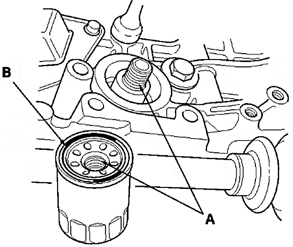

ENGINE OIL & FILTER, REPLACE
  1. Raise and support vehicle using a suitable lift.
  2. Place a suitable drain pan under engine.
  3. Remove oil filter using a suitable filter wrench, Fig. 1.
  4. Wipe off seat on engine block and apply a light coating of oil to new oil filter seal.
  5. Install new oil filter.
  6. Remove oil pan drain plug and allow oil to drain completely.
  7. Install oil pan drain plug, ensure that drain plug seal is not damaged, replace if required.(29 foot pounds. DO NOT OVERTIGHTEN)
  8. Lower vehicle.
  9. Fill engine with appropriate oil type and quantity.
  10. Start engine and ensure there are no leaks.
  11. Check your oil level
2005-honda-civic-engine-oil-filter-daigram
Fig. 1 Engine oil filter removal
