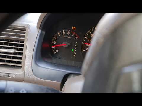

A video i made of the sound the car makes.
7th gen 05 accord i4 transmission issues
