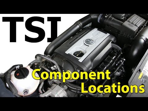

So I did a little more digging and found this video that points to the coolant temp sensor being inline in the Radiator hose. Look ahead to about 5:10 or so.
2.0t TSI VW Engine Component Location

  2. So I did a little more digging and found this video that points to the coolant temp sensor being inline in the Radiator hose(coolant pipe). Look ahead to about 5:10 or so. Added the video to the bottom of the original post above. Hope this helps.
