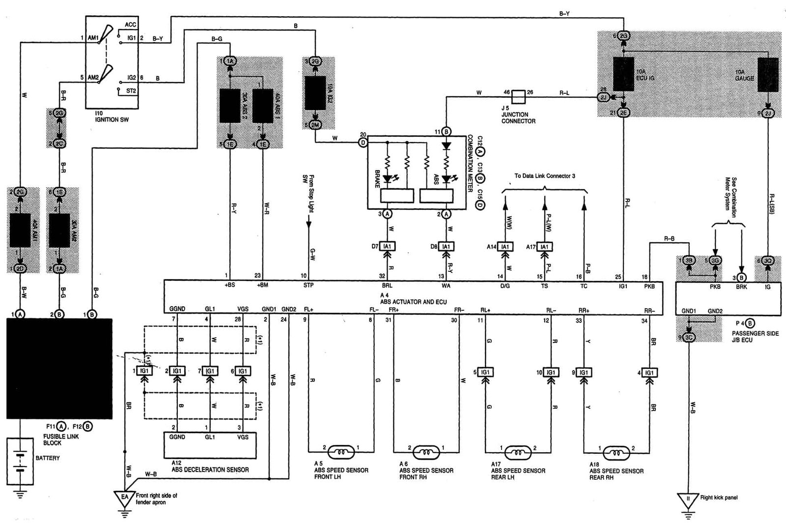

Looking at the wiring diagram(provided) there are four wheel speed sensors and one Deceleration sensor involved. Maybe that or an issue in the wiring harness is causing the issue.

There is more to it. This is a ACA21 AWD with a 1 AZFE engine.. The schematics explained in all places I have seen, refer to a 2WD. The AWD has a completely different set up.
There is a SKID control ECU located in the foot well near the gas pedal and there is a actuator mounted inside the engine bay. All the wheel sensor wires end up at the Skid. Skid Control ecu is Toyota 89540-42110 and the actuator is 44510-42020.
The Skid Control unit would do all the intelligent work including the ABS lamp and actuator drives the relays. when you switch on the IGN the SKID does a quick check on the Actuator and if good, switches off the lamp. The Orange/Red wire has nothing to do with the lamp.It is not even on pin 13 of Actuator connector.
