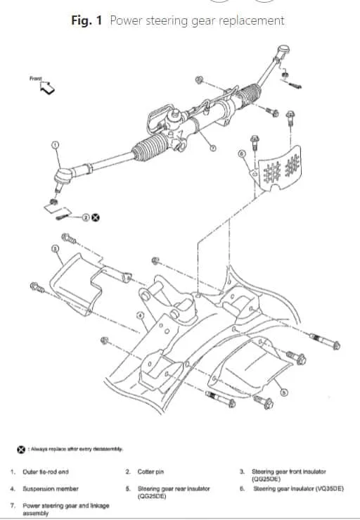

STEERING GEAR, REPLACE
- Raise and support front of vehicle, then remove wheels.
- Position a suitable drain pan below steering gear steering fluid hose connections.
- Disconnect power steering hose clamp, then the hose at steering gear. Allow fluid to drain.
- Disconnect tie rod studs from steering knuckles.
- Remove bolt securing lower joint to steering gear pinion.
- Remove lower joint from pinion. Refer to Fig. 1 when replacing power steering gear.
- Remove steering gear retaining bolts.
- Remove steering gear and linkage assembly from vehicle.
- Reverse procedure to install, noting the following:
a. Torque wheel lug nuts to 80 ft. lbs.
b. Torque steering gear mounting bolts and nuts to 114 ft. lbs.
c. Torque tie rod end nuts to 25 ft. lbs.
![2010-nissan-altima-hybrid-steering-gear-diagram](https://www.freeautomechanic.com/mechanic/forum/wp-content/uploads/2021/08/2010-nissan-altima-hybrid-steering-gear-diagram.jpg)
