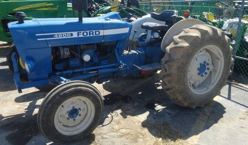

A tire on the tractor went flat, so I turned it off and filled it up. Once I tried to turn the tractor back on though it clicked once and would not turn over. How do I get it to turn on?
