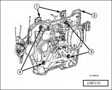

Front Door Window Regulator
  • Left side shown. Right side similar.

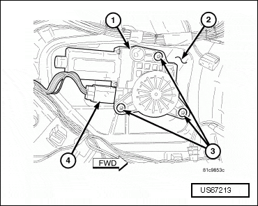

►Disconnect the wire harness connector (4) from the window regulator motor (1).
►Remove the 3 screws (3) that secure the window regulator motor to the carrier plate (2) and remove the motor.
►If servicing the window regulator, remove the carrier plate (2) and place it on a workbench.
►Remove the 4 screws (3 and 4) that secure the window regulator rails (1) to the carrier plate and remove the window regulator.

►If servicing the window regulator, position the window regulator rails (1) to the carrier plate (2) and install the 4 screws (3 and 4). Tighten the screws to 9 Nm (80 in lbs).
►Install the carrier plate.
►Install the window regulator motor (1) onto the carrier plate (2). If necessary, rotate the motor slightly to align the splines on the motor with the window regulator linkage.
►Install the three screws (3) that secure the window regulator motor to the carrier plate. Tighten the screws to 2.8 Nm (25 in lbs).
►Connect the wire harness connector (4) to the window regulator motor.
