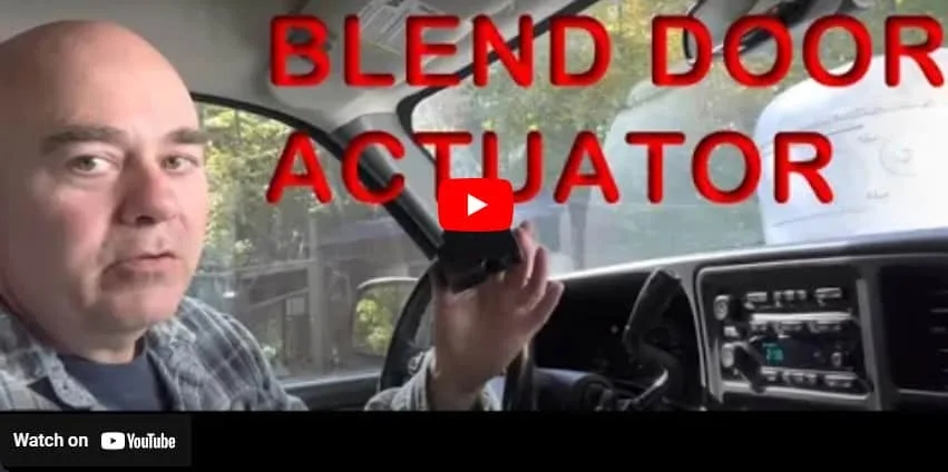

The Fix
The fix is to replace the Drivers Side Blend Door Actuator. Watch the video below to see how I replace the blend door actuator on this 2006 Chevy Silverado. Link to Actuator used in video: https://amzn.to/3CMMvfv
Just a few screws and one part and your back in business. Three 7mm screws hold the cover on. A two 5.5mm screws holding the Blend Door Actuator.
