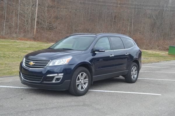

Transmission seems to “stutter” at 20-25 ph and 40-45 ph
If I had to guess I would say that the transmission was serviced with the wrong type of transmission fluid. They do sell a corrective additive called Shudder Fix. However the better course of action would be to have the transmission fluid replaced with the correct type. There is a TSB – Technical Service Bulletin out on this issue.
