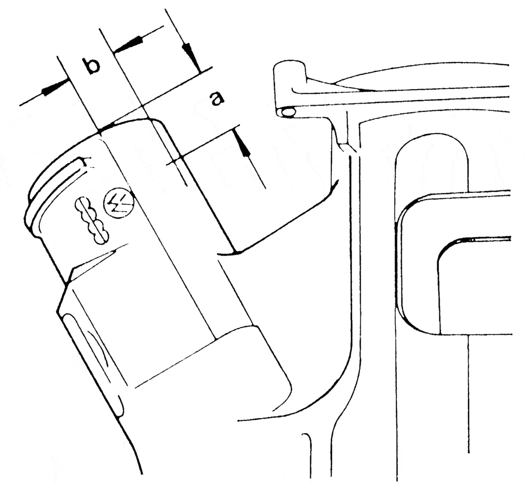

b. Using 1/8 inch drill bit, drill hole in lock housing approximately 1/8 inch deep as shown in Fig. 1. Dimension A = .47 inch, dimension B = .39 inch.
c. Using a suitable drift punch, remove lock cylinder with key by pressing in check spring using hole previously drilled.
