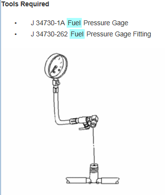

Check fuel pressure (52-59 psi)

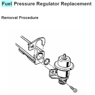

Check for leaking fuel pressure regulator.(on engine)
