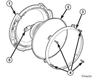

Headlight 2007 Jeep Wrangler Replacement
  1. Disconnect and isolate the battery negative cable
  2. Remove the grille panel from the front of the vehicle
  3. Remove the four screws (4) that secure the retainer (3) and the headlight unit (2) to the mounting collar (1) on the face of the front end module carrier
  4. Pull the retainer and the headlight unit away from the front of the vehicle far enough to access the wiring connection on the back of the light housing
  5. Disconnect the engine compartment wiring harness connection from the headlight bulb connector receptacle and from the position light bulb pigtail connector (5)
  6. Remove the headlight unit form the vehicle
